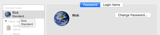

I use a “standard” (non-admin) user on my OS X Catalina system. Most functions that require administrative privileges prompt me for both a username and a password. Etcher only prompts me for my password, which isn’t enough for it to elevate its privileges.

sudo from the command line won’t work for me, because I’m running as the non-admin user “rick”:
rick@MacBook-Pro-723 ~ % sudo /Applications/balenaEtcher.app/Contents/MacOS/balenaEtcher Password: rick is not in the sudoers file. This incident will be reported.
This behavior isn’t new with Catalina; the “rick” user has never been able to sudo to root directly.
In any case, Etcher launched from the desktop used to work without a problem because the authentication dialog would allow me to enter both the “admin” username and its password.
