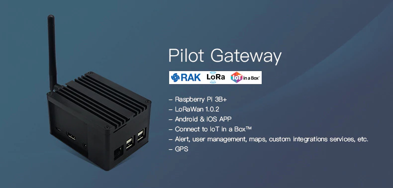

@m_emin_sahin0666 Which gateway are you using?
For example, the new gateway from PiSupply or a RAK backplane?
Rak Pilot gateway
Thanks for the information,
Now sure if you are already checking this git repository, but you can test with the settings in this section:
