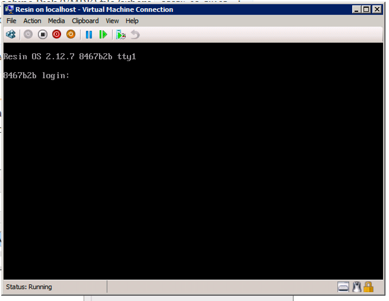

At this point the virtual screen of the VM shows GRUB and then resinOS starts.
The boot procedure shows al green OKs except one reporting: Failed to start Resin init flasher service.
Finally appears a shell to login resinOS (but is really hard to write into because doesn’t recognise each keyboard input).
The device never appears in the dashboard.

I was able to run the command journalctl -u resin-init-flasher --no-pager on the console and this is the output:
I think that the problem is that in hyper-V there isn’t the option to set a SATA controller for HDDs, only IDE controller is available.
Also setting IDE controller on VirtualBox instead of SATA results in errors, the device appears on the dashboard without any information.
