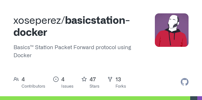

did you try to follow the steps from this repo?
Basics™ Station Packet Forward protocol using Docker
Let us know if that works!

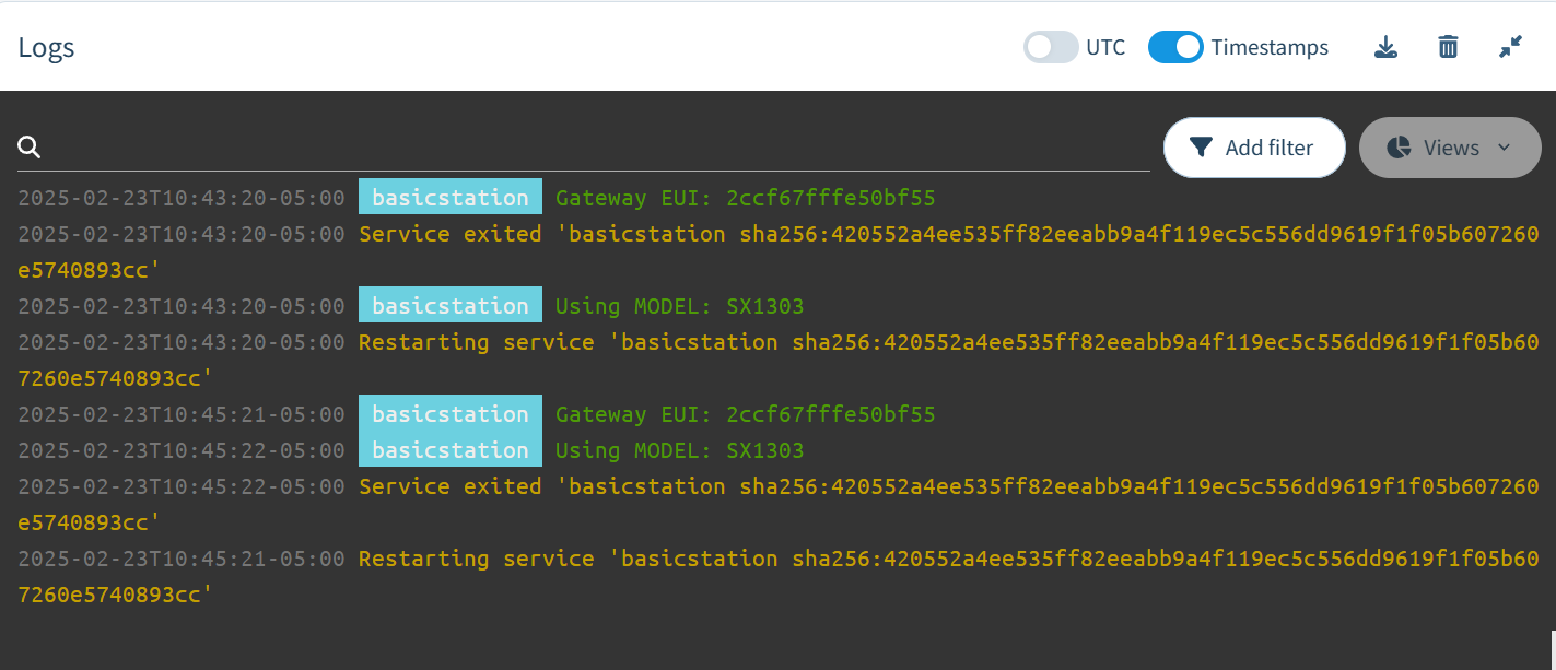

And could you please share the logs that you see in the Terminal from balenaCloud?
Thanks @LORA-BOOT

@xoseperez Hi, do you have an idea of what’s wrong with my configuration?

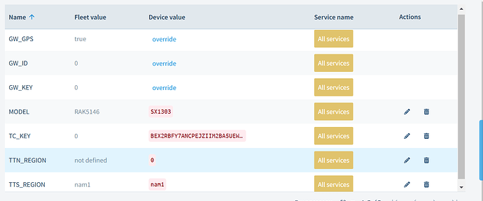

Please refer to the original repository for the right variables (GW_ID does not exist, GW_RESET_GPIO is deprecated). The error seems to happen very early in the starting script so my guess is there is some value it doesn’t like and somehow breaks the process.
Hi, I changed the variables as you said, but it’s still disconnected.
Delete the TTN_REGION, is deprecated but interferes with TTS_REGION. The TC_KEY should look something like “NNSXS.4YP2W…”.
