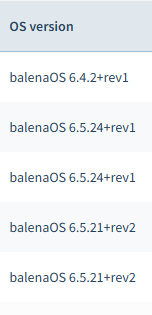

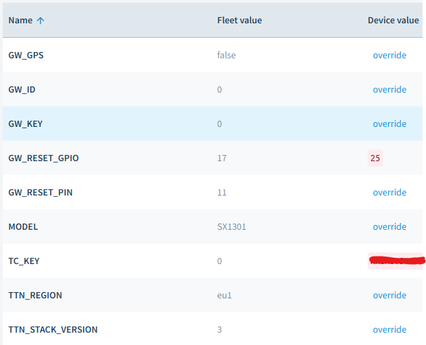

I have a RAK 2287 using Balena as the Basic Station. In UDP packet forwarder mode, the TTN server allows me to register the gateway, but the end devices are not able to join. I tried switching to Basic Station mode, but it doesn’t connect. Here are my logs:

basicstation 2024-10-04 05:15:56.205 [TCE:INFO] Connecting to INFOS: wss://localhost:8887
basicstation 2024-10-04 05:15:56.221 [AIO:INFO] TLS server certificate verification failed: The certificate is not correctly signed by the trusted CA
basicstation 2024-10-04 05:15:56.221 [AIO:DEBU] [4] WS connection shutdown…
basicstation 2024-10-04 05:15:56.222 [TCE:INFO] INFOS reconnect backoff 60s (retry 50)

So I’ve started from the begining. First anoying error is:
main ./start_sx1301.sh: line 24: /sys/class/gpio/gpio25/value: No such file or directory
main ./start_sx1301.sh: line 26: echo: write error: Invalid argument
Actual file structure is different:
root@ebf28f1:/sys/class/gpio# ls
export gpiochip512 gpiochip566 gpiochip568 unexport
So the question is how to adjust path or settings to avoid this error?
Variables are following:
Thank You
This issue became pretty annoying. It seem cause is in one of latest update. Now, the gateway with RAK concentrator have the same problem. The only action was update OS and supervisor. After first reboot, it doesn’t start anymore. Is there any observations with latest updates - I guess updates from last month?
@Robert83 could you please confirm that with older balenaOS (v5) version the basicstation application still works?
Thanks
Hi @mpous
maybe it is just a coincidence, but the situation is:
6.4.2 and 6.5.21 are online all three, 6.5.24 are offline
