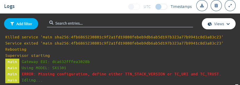

Hello @cGf googling about your error i found this Problem with certificates while building a TTN gateway with Balena cloud - #2 by Tallestxxl
which said that the issue was on the TC_KEY.
I tried with a new API Key generated by TTN, but unfortunately still disconnected and the same error showing up in Balena log.
That’s weird @cGf could you please grant me support access again via DM? :slight_smile:
You have access.
URL: balena dashboard
@cGf This is odd. Could you please delete the value of the variable TTN_STACK_VERSION? and leave the variable set up by the fleet?
I have deleted that variable and rebooted. Unfortunately, the same error persists…
Hi Marc, miraculous after doing a RESTART SERVICES the gateway is connected again to TTS and sending the messages from the nodes properly!!
That’s awesome @cGf :slight_smile:
Let us know if we can help you more!

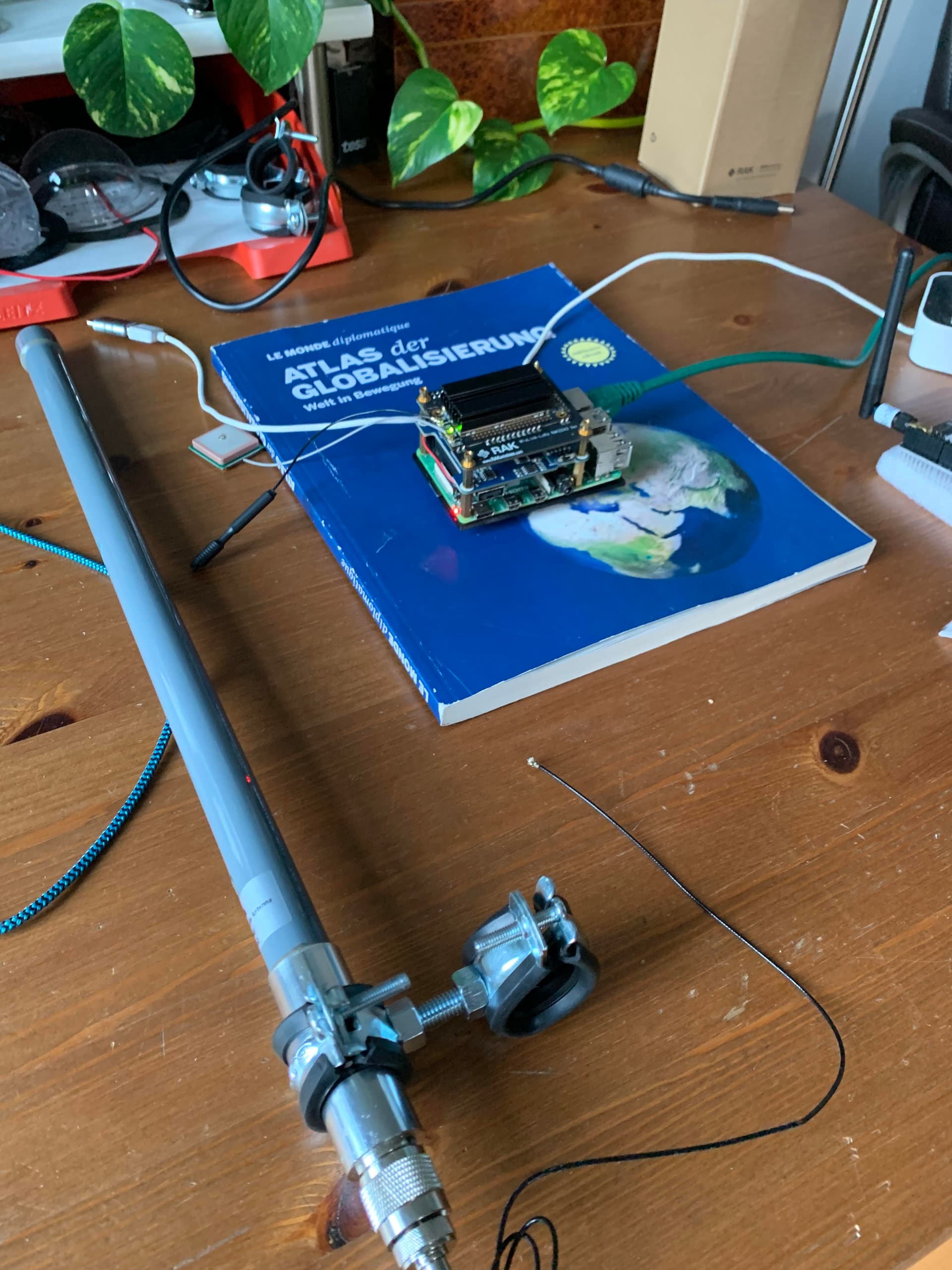

yes exactly, currently pretty happy with my setup. iam excited to test the 5dbi lora antenna with the rak2245.

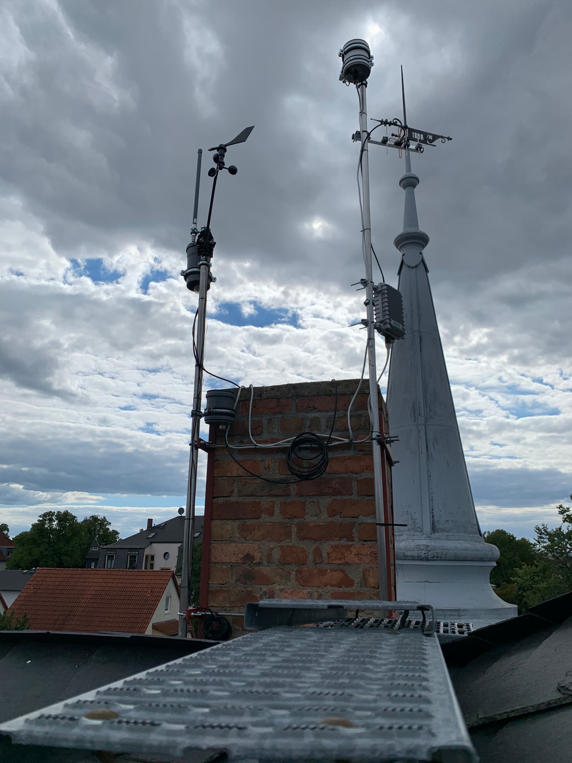

Look at this beauty @xoseperez & @nmaas87 :slight_smile:
Nice installation @Bra1nsen i see a Nebra hotspot! what else do you have there if you can disclose? :slight_smile:
Hey @Bra1nsen / Paul - geniales Setup. Das sieht ja mal wirklich gut aus. Sogar mit Blitzableiter? Cool. Ich sehe eine Windrose, Regenmengenmesser - was hast du noch alles oben auf dem Dach? Sieht super aus! :slight_smile:
Love the setup :slight_smile:
Thanks for sharing (and also to @mpous :smiley: )
