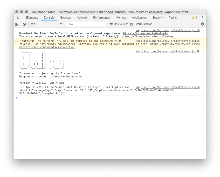

if the top panel menu shows up, can you open View > Toggle Developer Tools, go in the console and type window.screenLeft and window.screenTop to get the position of the window?
No luck
Try with a cmd + R while focusing the DevTools, that will reload the page which could show what went wrong (unless it disconnects again)
@thundron Tried that, immediate disconnect. Hang on and I’ll grab a capture of that too
Launched app from terminal with logging, selected the Etcher app from the dock, opened dev tools, dismissed “disconnected” modal, + R

Can you try typing window.screenLeft and / or window.screenTop next to the > @ryanquinlan ?
I tried in both cases. There isn’t an app instance to connect to, so you get no output from any commands you throw at the console.
