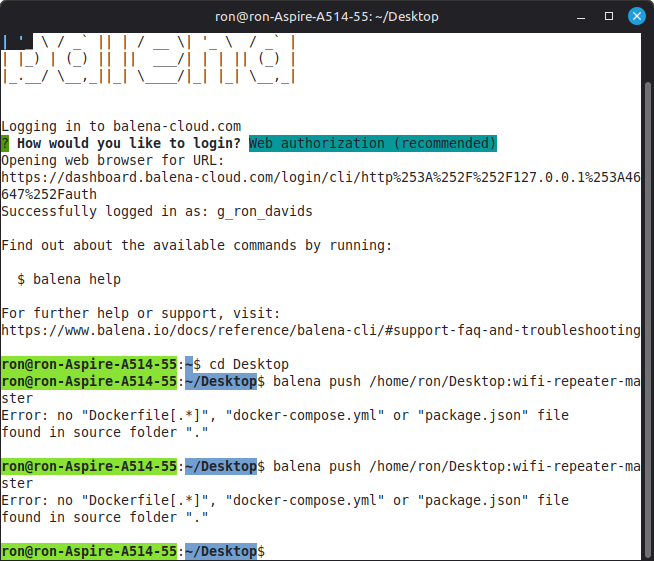

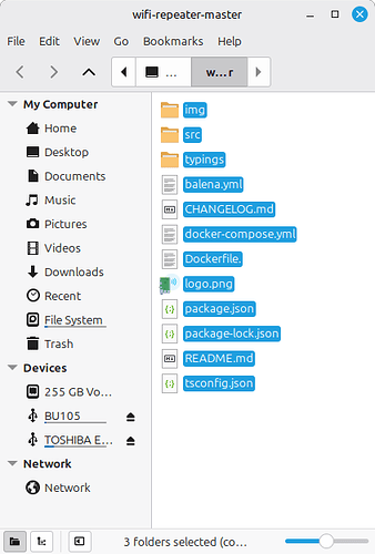

I have hit a dead-end. I’m trying to “push” wifi-repeater-master to my account with no success .I’m using Linux Mint (zara) on a laptop. I have successfully installed Balena CLI, and can login. I have made sure Docker.service is installed on the laptop and running, have been to many blogs, googled problem with no success. I’ve made sure that all the software is the correct version, etc.All three files mentioned in the screen shot are in the wifi-repeater-master folder. Any help would be appreciated. Thanks
Make sure you are inside the project’s root folder (the one that contains the Dockerfile, docker-compose.yml, or balena.yml).

Thank You very much for replying, rojasyal. Your explanation makes perfect sense, however, again I receive an error massage….“BalenaAplicatioNotFound”. Beginning to wonder if I was meant to complete this project. :joy:

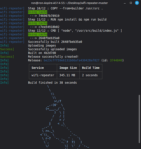

I think I got it to build. Rather than- balena push , I tried balena push / and it worked, however I can’t get my device to connect to the cloud now. Another problem for another day. Thank You for taking the time to help me…made me realize I needed credentials on the cloud end…kudos to you!
Just a quick note that balena push does not accept device UUID directly. You’ll want to use either your fleet name/slug (for cloud deploy) or the device’s IP / .local hostname (for local deploy). You can check examples at balena push --help.

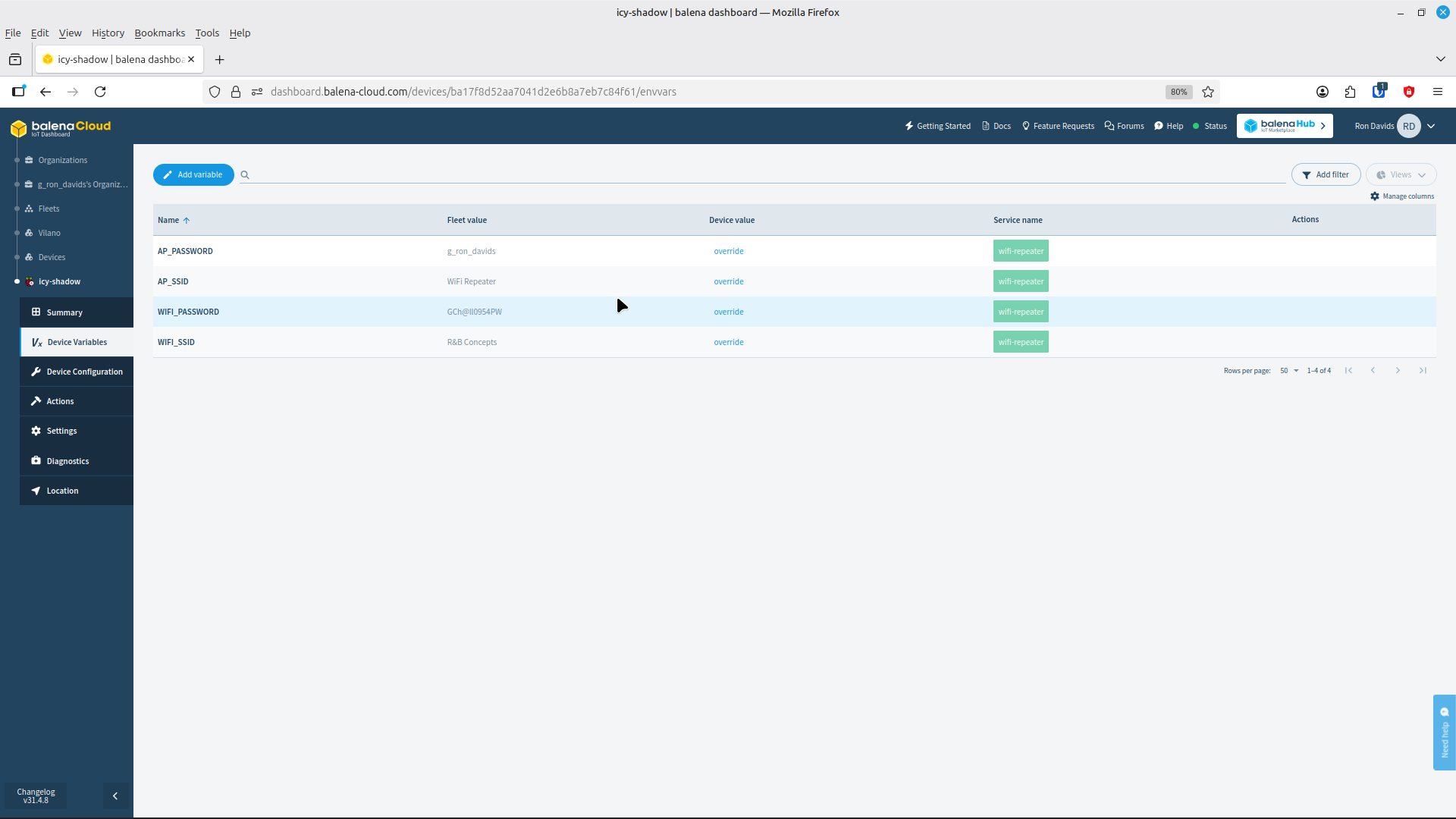

About the WiFi issue: it’s probably not connecting because the environment variables for repeater mode haven’t been defined yet. You need to set them in Balena Cloud under your device or fleet Environment Variables

Hi Thanks for the reply. I had configured the variables, hopefully correctly. I need to check out the wifi dongle…will let you know tomorrow.
