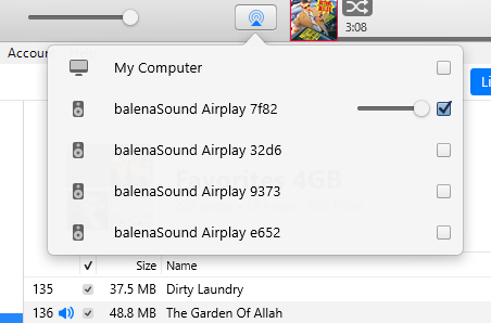

WiFi on my network is built on three Ubiquity UniFi AP-lites and an EdgeRouter PoE. I don’t think WiFi Direct is in action here, but honestly I’m not certain. I would expect the balena-sound stuff and iTunes to be explicit if it were using that. My iTunes didn’t indicate anything specific about how it is connecting to Shairport-sync. Also, the RPi server is physically pretty far from my desktop, so it would be a weak signal if it was direct between the two, and there weren’t any playback quality issues at the time.
This is what iTunes looks like:
