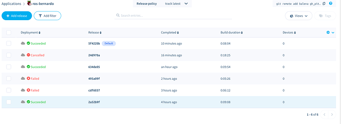

Could you take a moment and respond to my specific questions and screenshot?
What do all these releases mean? I’ve been experimenting and now I don’t know what code is being uploaded to the raspi. It can’t be all of these?
Each time you push code to Balena you create a new release. Only one release is active on your devices at any time (usually the last one you pushed).
From what I gather, an “application” is just a name for a set of devices that all have the same kind of hardware and run the same software.
Correct. An ‘application’ is a group of devices all running the same software. When you push to an application, all devices associated with that application get updated.
