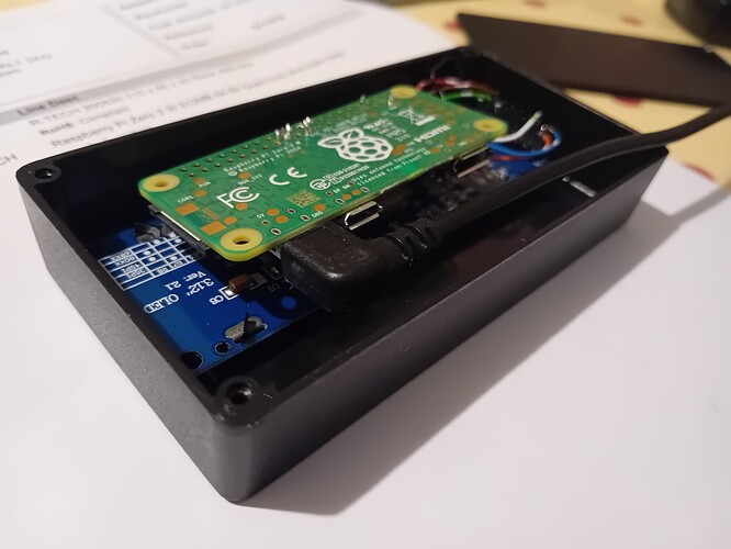

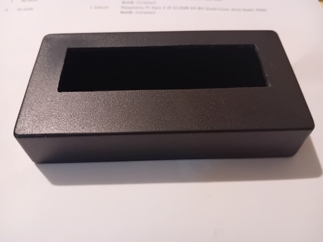

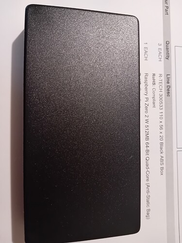

I used a RTech 300533 case 110 x 56 x 20 as I dont have a 3D printer.
Used a junior hacksaw, small file, and sticky back foam tape to put it all together. The foam tape fills the case and stops it all moving about.
I used the 3.12 inch display, £7 from china inc p&p.
Only thing I would really like is to be able to change wifi and passwod without having to take the sd card out. I’m a real newby at this. Anyone??
Quite pleased with the result!
