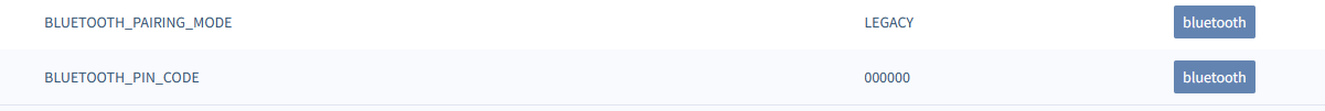

As mentioned by heavy-matill, I did set the variables, I used a 6 number PIN and it did not work on my iPhone 7. I did not try a computer nor the 000000 PIN (I now realize I should have). Anyway, I always got a timeout error on my iPhone. (edit: BTW, the Bluetooth pairing worked great without the LEGACY + PIN variables… I just wanted an extra layer of security because my use-case is similar to Snellie’s)

→ When setting custom variables BLUETOOTH_PAIRING_MODE and BLUETOOTH_PIN_CODE I get the pincode-screen on my phones, yet after typing the correct pincode I still get the “pincode incorrect” message. My tablet won’t connect at all.
