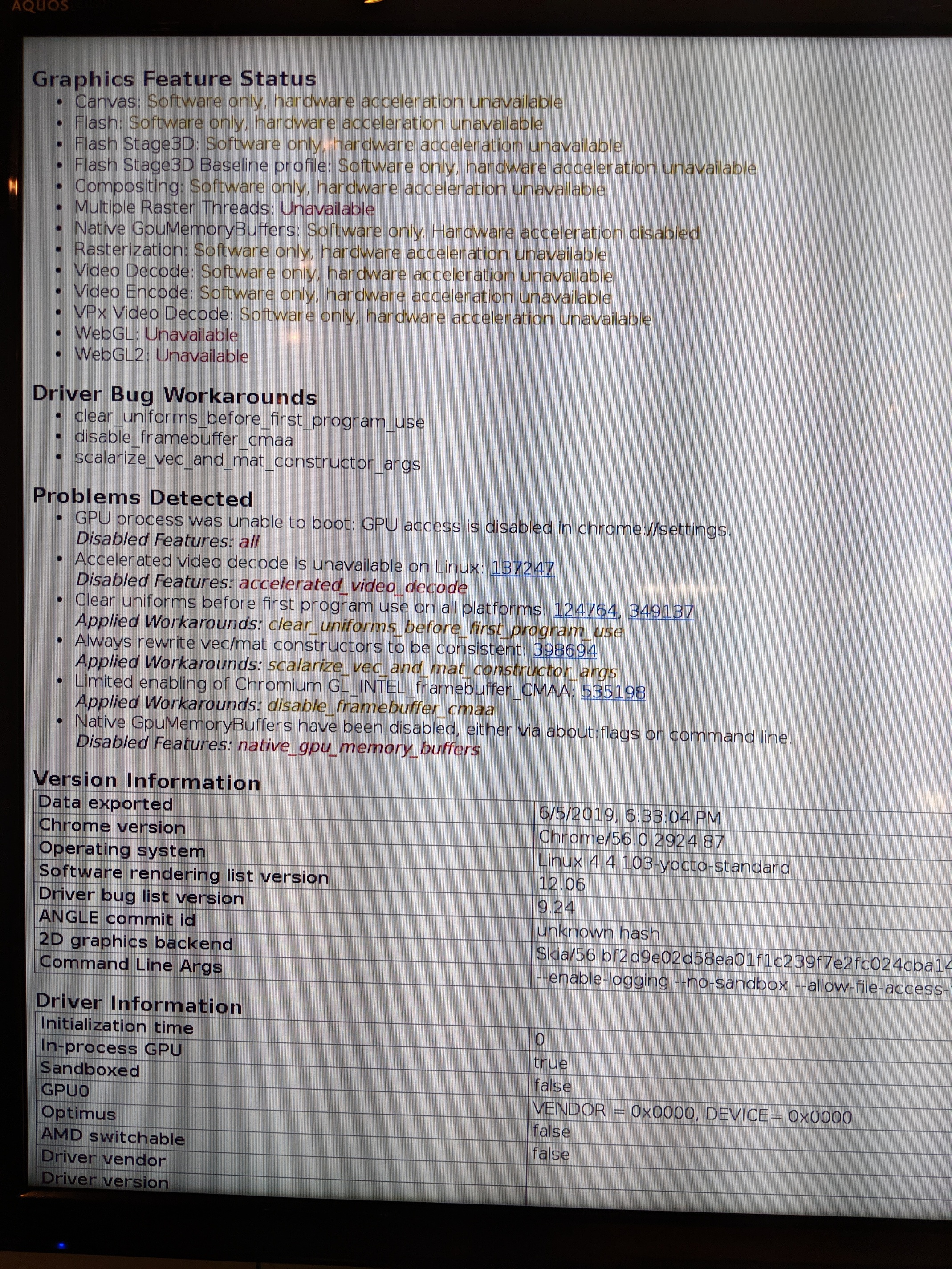

@dansku Thanks! I’ll look into the Dash, though will prefer building on electron. I think the issue might be with the chromium build in this version of Electron
See attached the gpu info
Hi @pjs , I’m no expert on this stuff,but I think one of the main issues with electron GPU acceleration on most of the ARM SBCs is that they use a MALI gpu which doesn’t yet have great support in x11, I think there is some good support for them in wayland, but as of yet electron doesn’t support wayland. So we are still pretty far off good GPU accelerated electron on these boards. If you find a way to get this working, our team and community will be super super interested, we have been trying to solve it for a while (one of the reasons we ended up building Balena WPE, which balena-dash is based on.)
