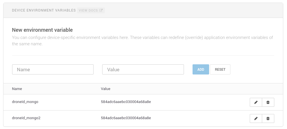

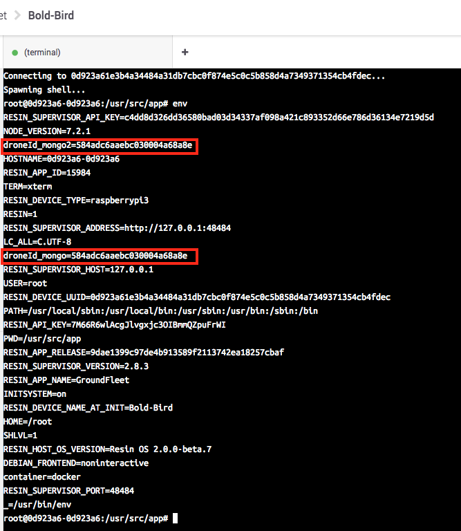

Hey there - no, it’s not a RESIN_ variable, it’s just a device specific ENV variable. For example:
(This is the same is Safari, Chrome, and Firefox) Here is the ENV page of one of my devices:
Yet this is what the environment actually is (from that same device):
I think this is just a JS webpage issue, I can see the REST call the front-end is making to get the ENV variables (https://api.resinstaging.io/environment?appId=…). It respond correctly:

It just doesn’t show on the page. You’re not seeing this as well in staging?
Thanks for the detailed feedback, really appreciate it! I’ve just tried, and don’t see it happen myself (on Chrome / Linux).
What operating system are you on? Do you see any similar issues on production? Since it’s staging, it is indeed not guaranteed to work at any given time, but we are checking whether this is a known issue, or a regression.
