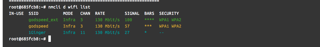

Trying to run wifi-connect on jetson nano , getting below error
device uuid - 685fcb8a6920acadfc64fedca8c62c66 , in case someone from balena support wants to look.
nmcli d wifi list output ----

Thanks for providing the UUID. I will check the NetworkManager and kernel logs now.
The WiFi dongle attached to the device does not support access point mode (or the driver it is using does not support it). It is hard to find a WiFi dongle that runs flawlessly on Linux. I would advise for trying out a few different ones and see what works best for you.
