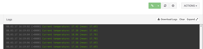

New feature just released in the dashboard - now you can download your device logs, through the Download Logs button just above the logs tab in the device summary page:
