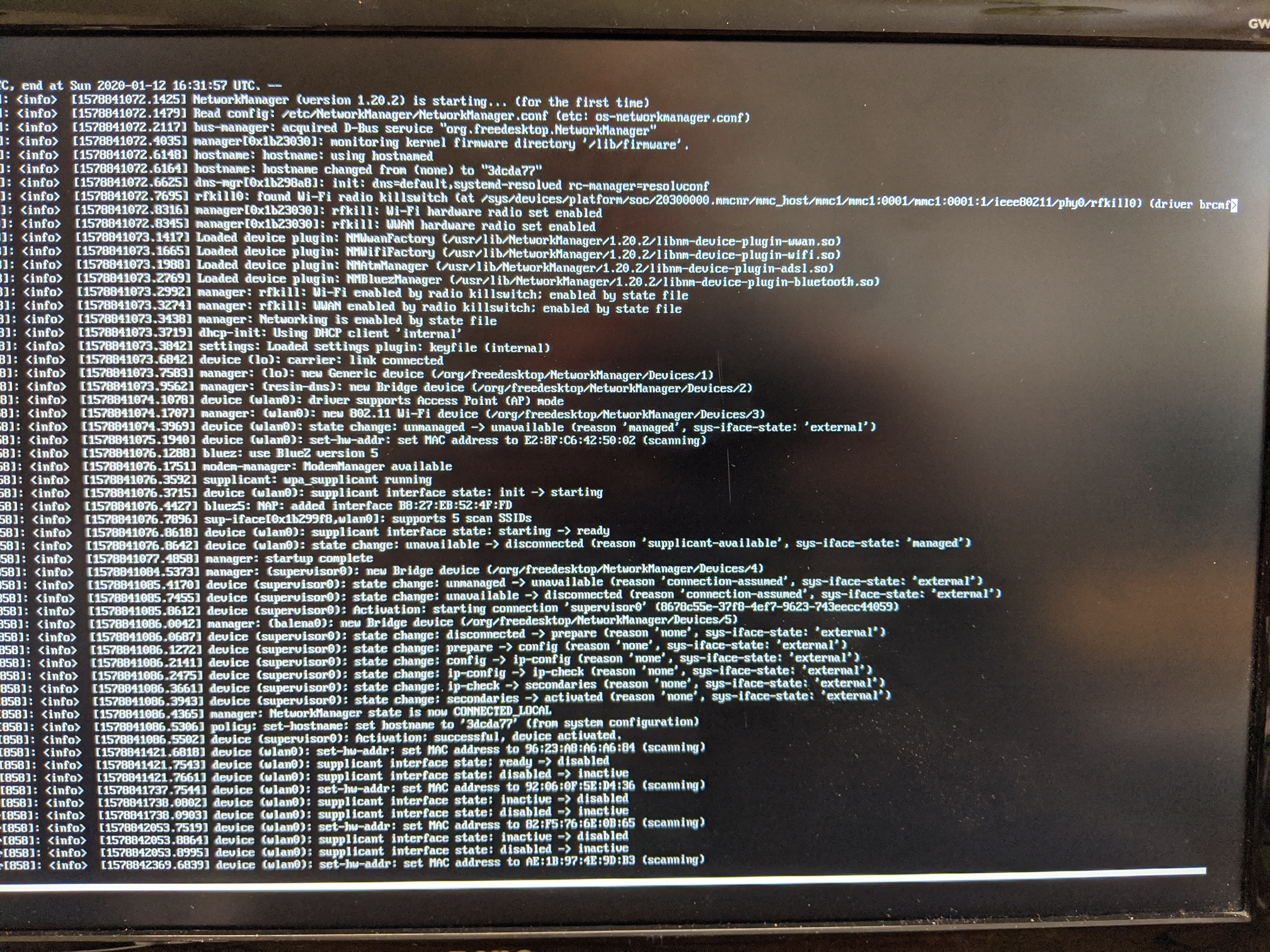

Now, this is odd. When I use the command ‘nmcli d wifi list’ I can see my neighbours’ WiFis but not my own! If I run WiFi analyser on my phone, it can see my WiFi. This is all on 2.4GHz. So, I can’t understand why that is, especially when running Raspbian on the same board does see it. Just tried using my phone as a WiFi hotspot and that can be seen, so must be something odd with my router, even though all my other WiFi devices see it OK.
That is very interesting. I wonder if perhaps your router is not using all the bands and your neighbours is, that would explain why it would get seen and not yours. I remember there was some previous issue from a user with n and ac bands on the router AP, but I can’t remember exactly. I will try dig out that issue if i can.
the other thing to try is to pass the nmcli d wifi list --rescan option so that it forces NM to do a proper full scan of network. It also might be worth just trying to connect to your network with the nmcli d wifi connect ... command and then seeing what the logs say.
Tried the first suggested command and it still only reports other networks. I tried the connect but, unsurprisingly, it says it can’t find that SSID.
I just tried Raspbian again on the same board and that worked fine. It appears in my router with the correctly assigned ip address.
The balena version keeps saying ‘IPv6: ADDRCONF(NETDEV_UP): wlan0: link is not ready’ implying it is trying to use IPv6. No mention of IPv4 anywhere.
