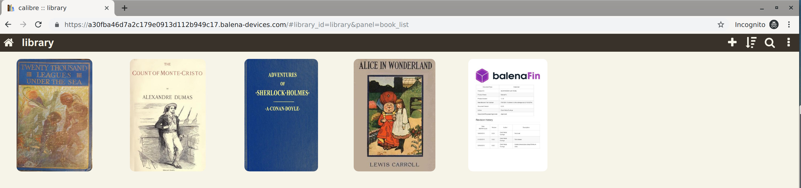

If you enable the Public Device URL for the given device, you can connect to the library remotely (including uploading and reading books):
