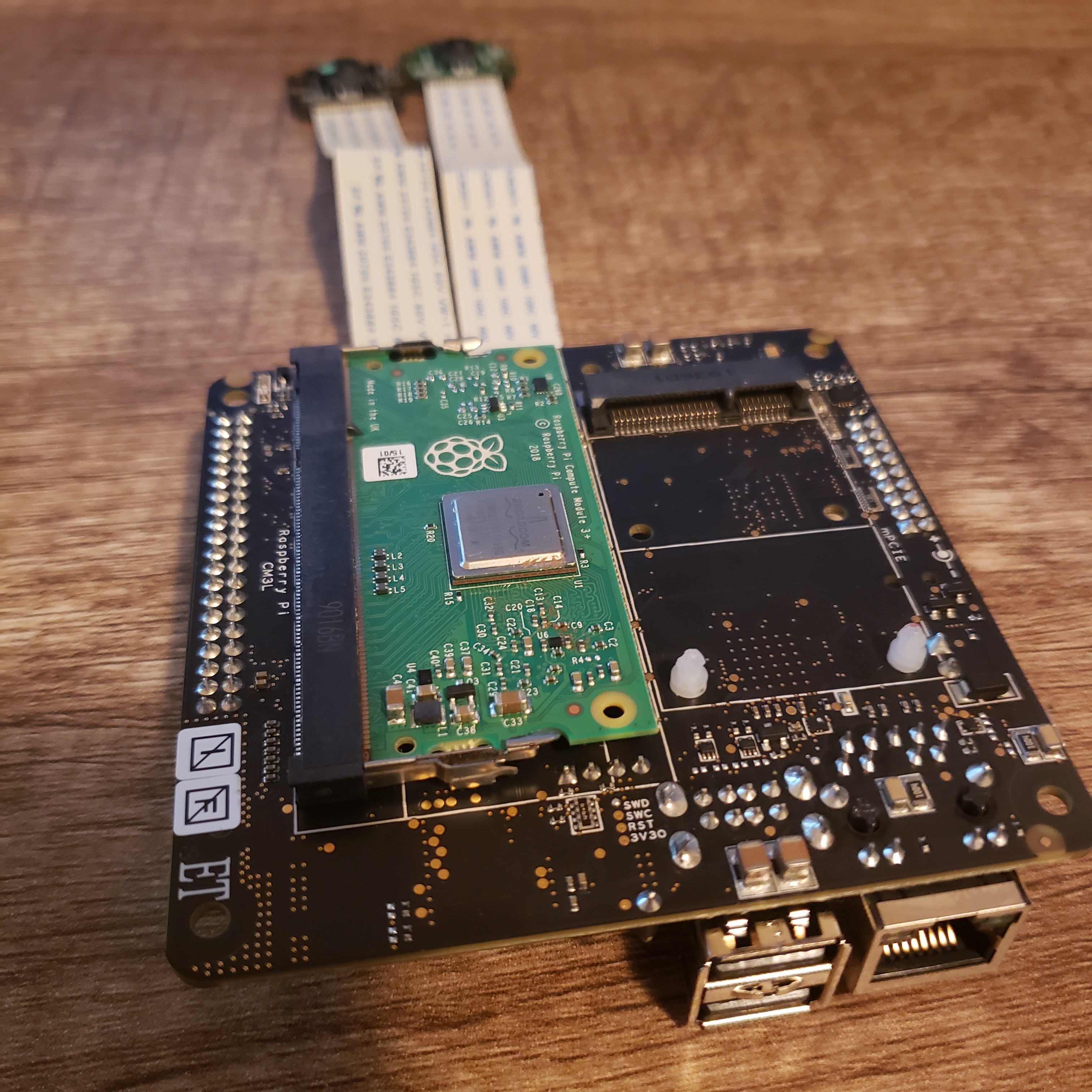

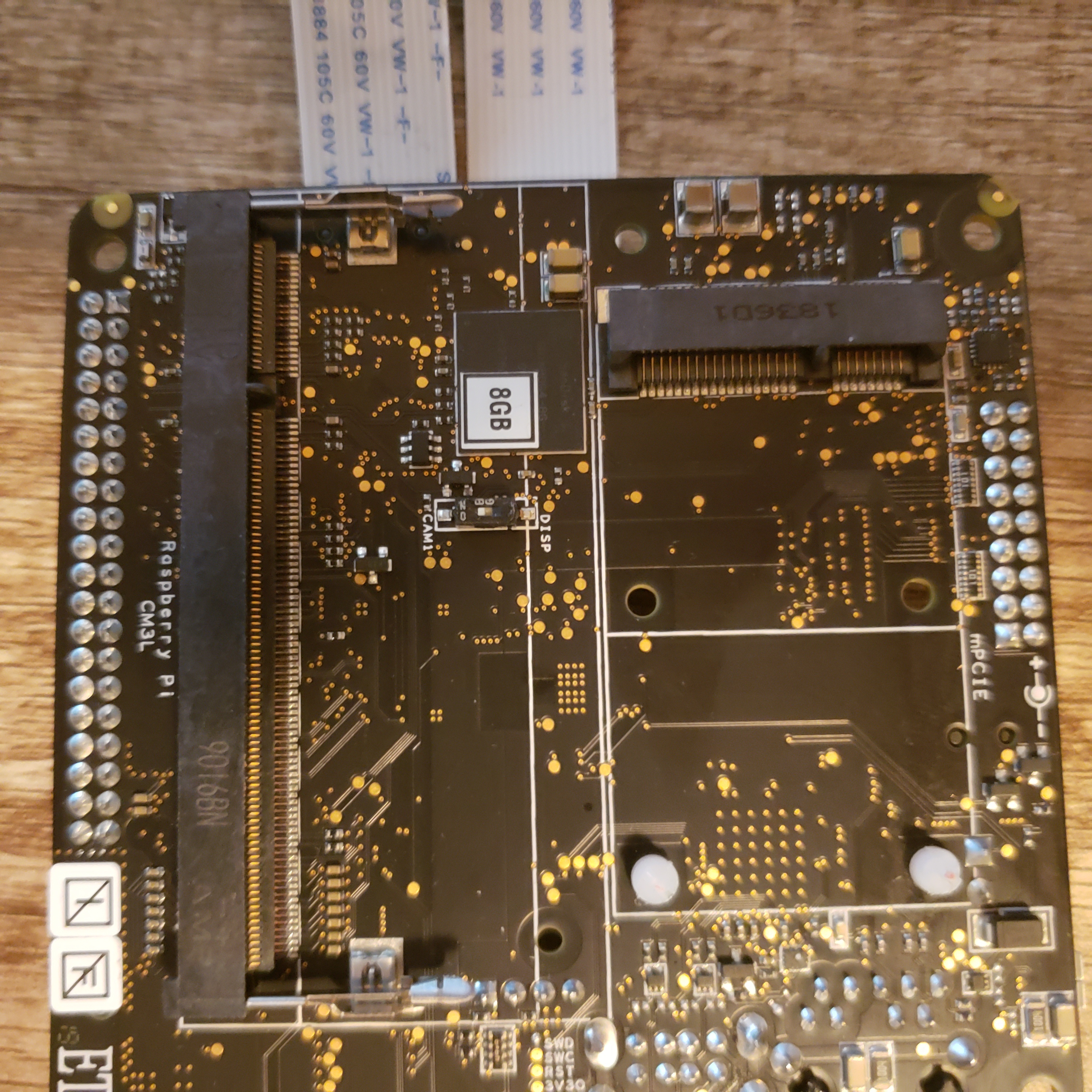

One thing that would help with investigations - would you be able to send us a couple of photos of the hardware setup? :
  • A photo of how the camera is connected
  • A photo of the dual camera switch
    Thank you
Hi,
Here are photos of the hardware setup.
Hi
  • Thanks for sharing the photos - everything looks correct to me.
  • One thing that I just wanted to ensure - have you tried swapping the cameras and verifying that both work? For the off chance that we have a faulty camera situation.
