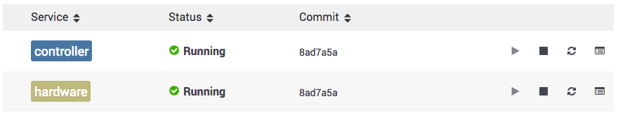

We have a multi container setup with two services, called hardware and controller. In the resin dashboard they are both reported as running with no errors, however, when attempting to start a terminal session with either container the shell is unable to spawn.
The following message is displayed on the shell continually, I have attempted to restart the running containers but to no avail. The shell does work successfully when connecting to the Host OS which gives access to dmesg output to shine a little more light on the issue.
Spawning shell...
Application container must be running for a terminal to be started.
SSH session disconnected
Here is a section of the output from dmesg shortly after the controller service was last known to be running. We know that the service was running up until 7:15 as there are logs available which show the system operating at that time.
Any insight as to what is occurring in the following lines would be much appreciated? I have left the system powered on in its current state in order to make debugging possible. I am sure that manually power cycling the system would resolve the issue however I would like to avoid this solution as it will not be a solution available to us in production.
