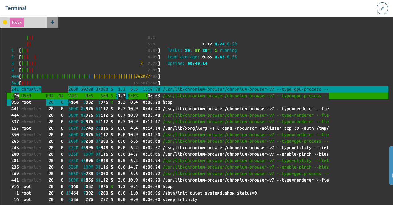

I am noticing something weird when running a node express server on Balena Cloud. In fact, I am installing htop in my container, and when i run it I get multiple processes, all running that same node server. What’s happening? I am attaching the Dockerfile and a screenshot of the htop result:

@nazrhom no it does not happen on other machines (i see only one /bin/www process running). Also, it seems to happen regardless of node. For example, you can see below a container running the code from github.

@nazrhom looks like htop shows threads, not processes. If we want to only see the main thread we need to press H apparently. So things make more sense now.
What I am still unsure about is why multiple threads are being shown for the node process. I always thought node was single-threaded…
Oh, I had just stumbled in the same thread, wasn’t aware of that. As far as as node being single thread that is true, but it is to be interpreted as: there is one thread that runs JS code. The runtime will still have a thread pool that takes care of the blocking (IO, ecc) operations; for example when you call a function like readFile
the JS thread will hand off the blocking system call to one of these threads. This way the JS thread can continue executing while the other one is reading the file, eventually the JS thread will get the results and run the callback.
