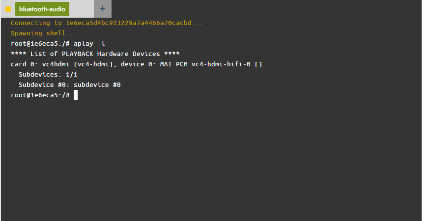

I saw previously a Balena Team member had asked to run “aplay -l” under Bluetooth here was my result:
I could be seeing this wrong, but is there no 3.5 output listed?? I am using the 3.5 output
I also still have remote access enabled
I saw someone else had this issue and they said to " I think you are hitting a known bug with our 64 bit OS. The workaround is to remove the vc4-kms-v3d dtoverlay setting from the Device configuration page of your device. Let us know if that works!"
Just tried that - it works!! - But there is a noticeable 2 second delay between pushing play and the music starting
