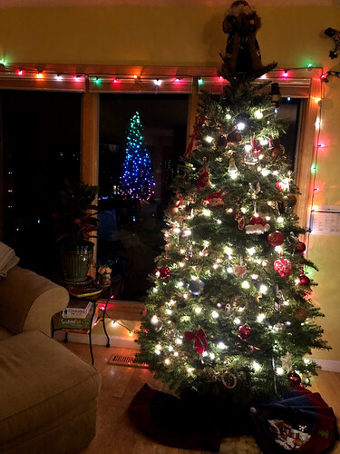

Outstanding – thanks @chrisys! Just a quick git pull and balena push and I’m off to the races. While I’m waiting for the build to push – adding a few more photos of the project, now ‘in situ’:
As seen from the living room (rig is mounted on our front deck):
As seen from outside, below:
As glimpsed between trees and houses from blocks away, on a dog walk:

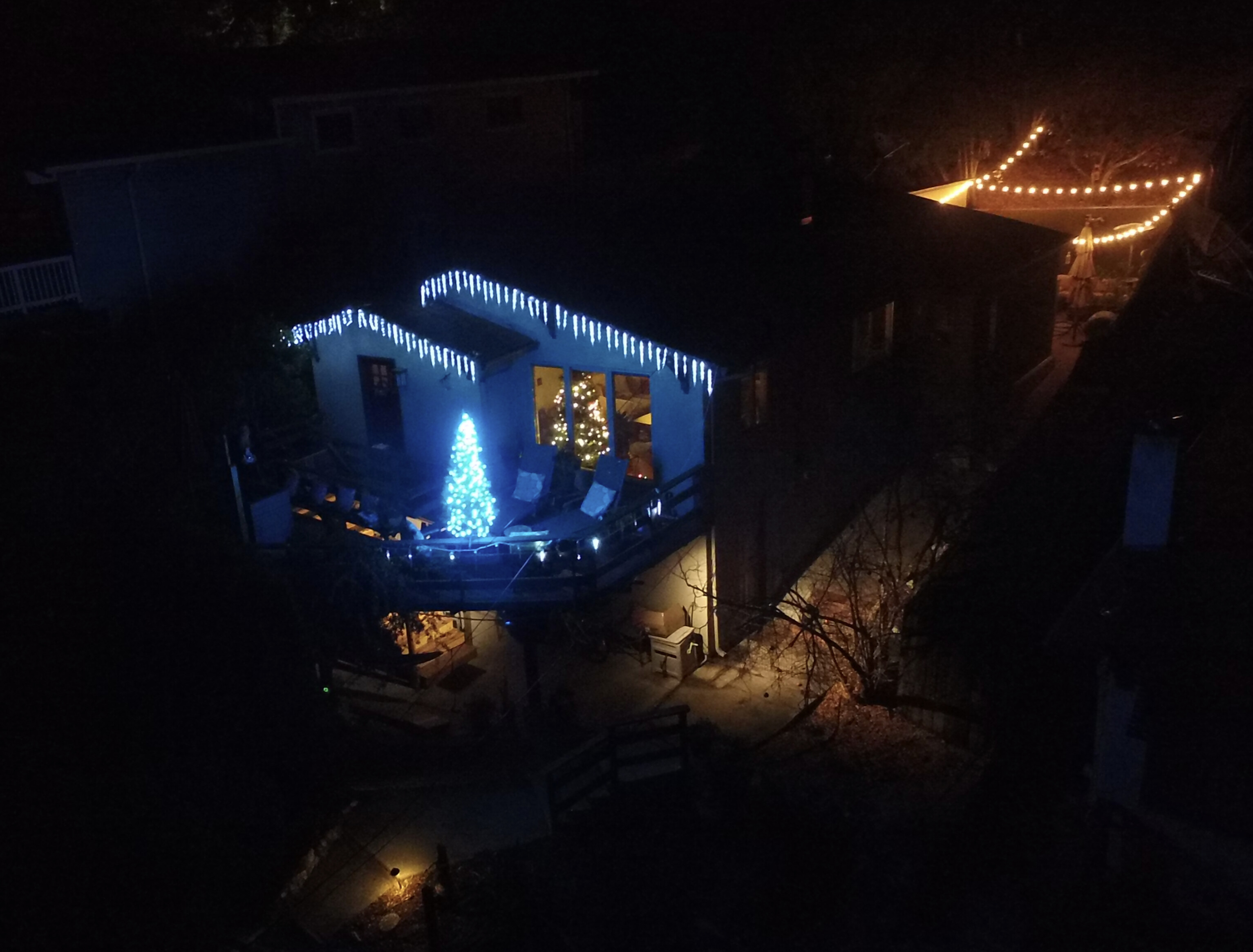

Finally: A couple of gratuitous drone shots:
Link to full album of project photos, and even some drone video showing off some of the demo patterns:
