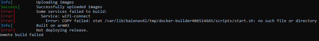

Sorry for needing so much assistance, I greatly appreciate the help as I’m just trying to learn. It was pushing the project perfectly but apparently im missing start.sh
What can I do?
The start.sh script is in the scripts folder which I took from the wifi-connect zip, I put the scripts folder in the merged app directory
Hi
In your Dockerfile, you must be copying the start.sh over to the container. Can you check if the file exists in the same relative path as the one that’s mentioned in your Dockerfile? Looks like you might have moved the Dockerfile or start.sh files in such a way that it’s no longer in the same relative path.
After some trial and error I placed the scripts folder in the same folder in the correct area. Thank you so much!

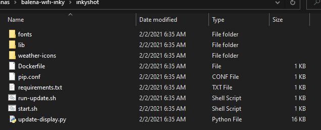

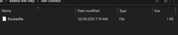

Hey, I am trying to redo this because I was to give this as a gift and realized the order of which the services started was not right. Plus the services in general are no longer updating properly so I decided to restart. Im am running into the same issue I had earlier, when I attempt to push this file it says “Error: no “Dockerfile[.*]”, “docker-compose.yml” or “package.json” file found in source folder “.””
I have a master docker-compose.yml in the main folder, I have the 2 services copied inside correctly. I have two seperate dockerfiles for the services, both of which are in two seperate folders and are pathed within the “build:” of the docker-compose.yml. What am I doing wrong? Screenshot 2021-02-26 095726 Screenshot 2021-02-26 095731 Screenshot 2021-02-26 095736
Thank you guys for all the help, it means to much!
Hi there @MM2020 could I check what you’re trying to do here? It looks like maybe you’re still trying to add WiFi connect to Inkyshot, but the cause of the issue and confusion might be that the Inkyshot app now includes WiFi connect.
When we first released the Inkyshot app it didn’t include WiFi connect, but it now includes it. Inkyshot was changed to a multicontainer application and so the Dockerfile moved one level deeper. However if you’re still trying to add WiFi connect there should be no need to do that any more and you can push that project as it is (or use the DWB button!).
Your folder structure screenshots are a little confusing so it’s hard for me to work out what files you’re intending to use, but it does look correct from what I can make out. As long as you’re executing the push command from within the balena-wifi-inky directory it should work, but as I said I’d recommend just pushing the latest version of Inkyshot which now includes WiFi connect, if that’s all you’re trying to do :slight_smile:
