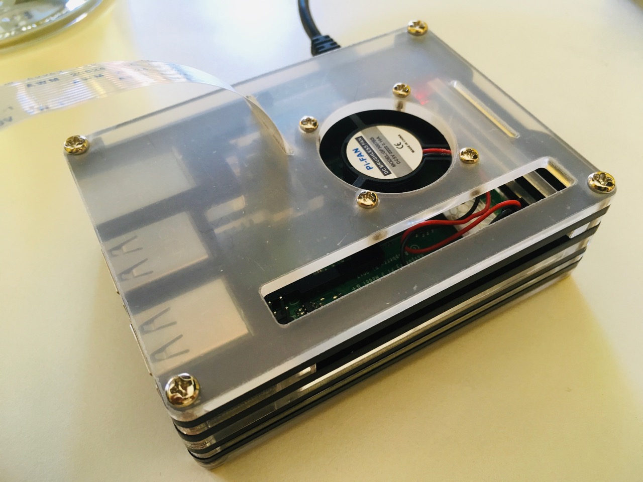

Case
Like this one. Can easily make new holes for some camera holder.
Photos
Case

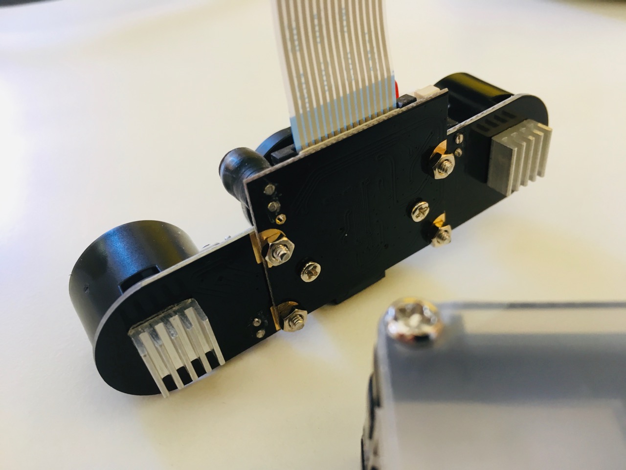

Camera - front
Camera - back
As you can see, I did attach small heat sinks there. These LED lights can be pretty hot in a few minutes. Let’s see how hot they’ll be after couple of hours :slight_smile:

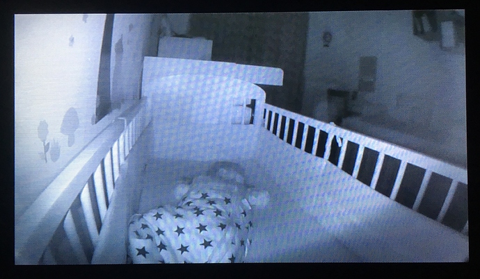

Not as sharp as the 8M V2 camera (this one is 5M), but good enough for my use case. Photo of the 7" screen (800x480) with the stream. Have to tweak potentiometers a bit to catch the right moment when it switches to night mode.
