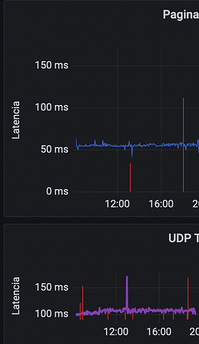

After the reboot, tests look like this
but, at 19:12 they start to look worse and my nping stops working:
you can clearly see the problem.
