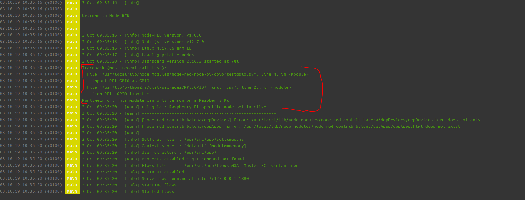

When the container starts I’m getting this error:
I’ve made sure that my dockerfile includes:

I wanted to have a look but screenshot is not readable for me.
Maybe also share your full dockerfile.

Hi, thanks for the reply. So the error I’m getting is:
Traceback (most recent call last):
File "/usr/local/lib/node_modules/node-red-node-pi-gpio/testgpio.py", line 4, in <module>
import RPi.GPIO as GPIO
File "/usr/lib/python2.7/dist-packages/RPi/GPIO/__init__.py", line 23, in <module>
from RPi._GPIO import *
RuntimeError: This module can only be run on a Raspberry Pi!

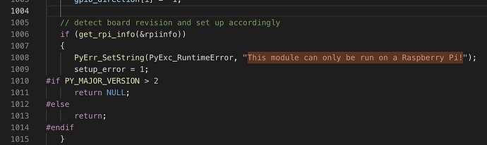

There seems to be a compatibility issue between raspberry pi 4 and python-rpi.gpio library.
FYI: I found the error back in file py_gpio.c of the python-rpi.gpio package.
