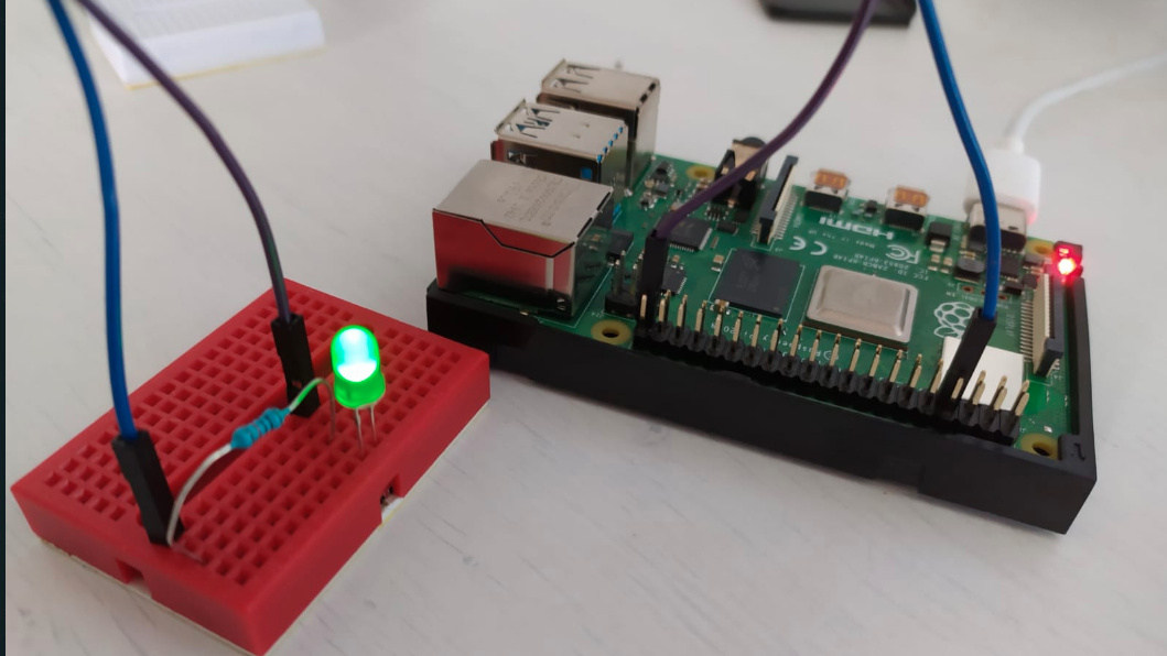

test this flow with rpi4
Hello !
That seems to be a problem with that the library, I might also be regarding the architecture of the raspberrypi4
I could reproduce the error on those particular pin, I have tried it on GPIO4 (pin7) and it works fine.
I will try to see if there is a workaround/fix for that, ut I couldn’t find anything so far
ok!!!, i hadn’t thought of testing it like this!
it works up to port 26
there is still a problem because we cannot use ports 27-> 40
