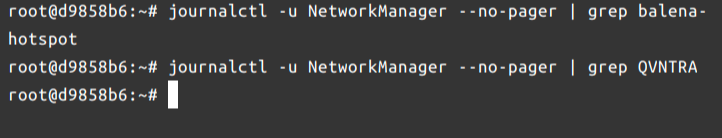

In your NetworkManager logs I don’t see any reference to balena-hotspot being discovered and loaded at all, can you grep the earlier logs to see if there is any mention of the config not being loaded?
journalctl -u NetworkManager --no-pager | grep balena-hotspot
journalctl -u NetworkManager --no-pager | grep QVNTRA
HOST OS VERSION = balenaOS 2.69.1+rev1
It’s ignoring my configs :frowning:
Bump. I have proactively enabled ‘Support Access’ to expedite any help here.
