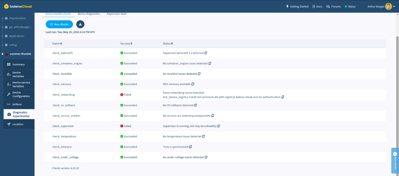

After my local internet dropped during an image building on my computer, I completely lost control over my balena device on Balena Cloud. I can’t reboot, restart, stop services, and can’t see the logs (the past logs are still there but the new ones which should appear after an image upload, aren’t).
The building release hash on the computer matches that on the Balena cloud, yet.
The supervisor seems to be having problems connecting to its own database:

Hi, we got the logs above from the diagnostics file that you sent. Can you get more recent logs from the supervisor by the running the command journalctl -u resin-supervisor from the HostOS?

Thanks for sharing those logs. We have observed the error Knex: Timeout acquiring a connection. The pool is probably full with devices doing very fast logging on a container, which is consistent with your hypothesis 1.
Could you try pushing a new release with reduced logging on your container to see if that is the culprit here too?
