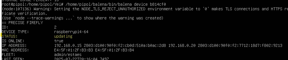

I’m having issues — the devices aren’t downloading the new deploys; they get stuck in “updating” status. The deploy does complete to 100%, but the devices don’t download it.
These are my containers:
