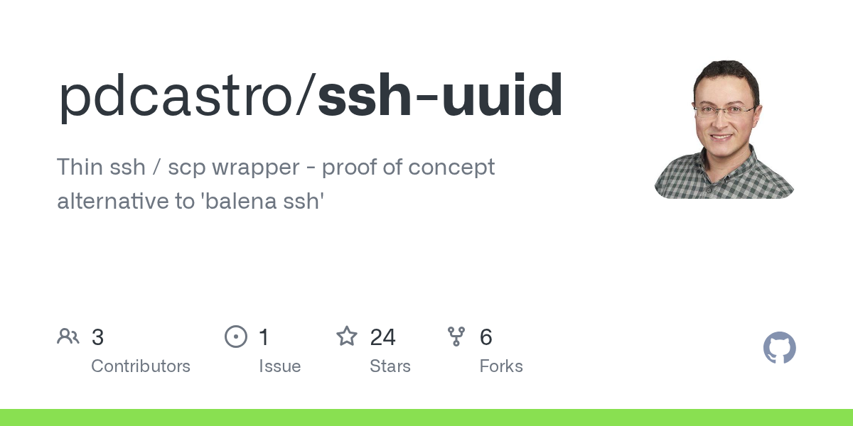

You can.
Tunnel into the device then scp from the shared volume to your computer.
We’ve used this tool successfully.
