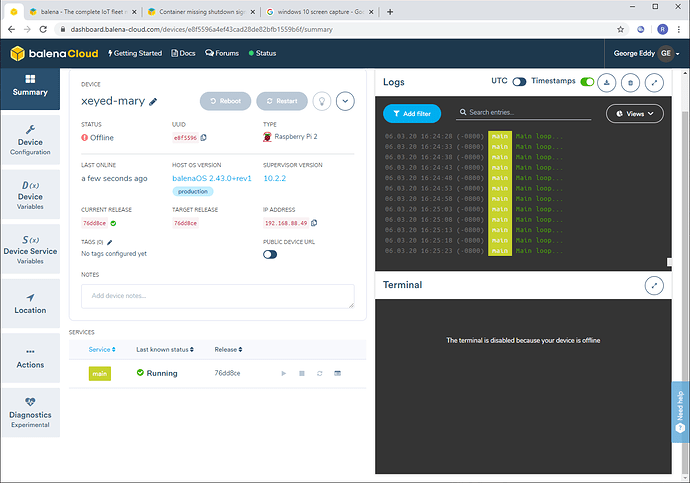

And here is just the container with your code…
