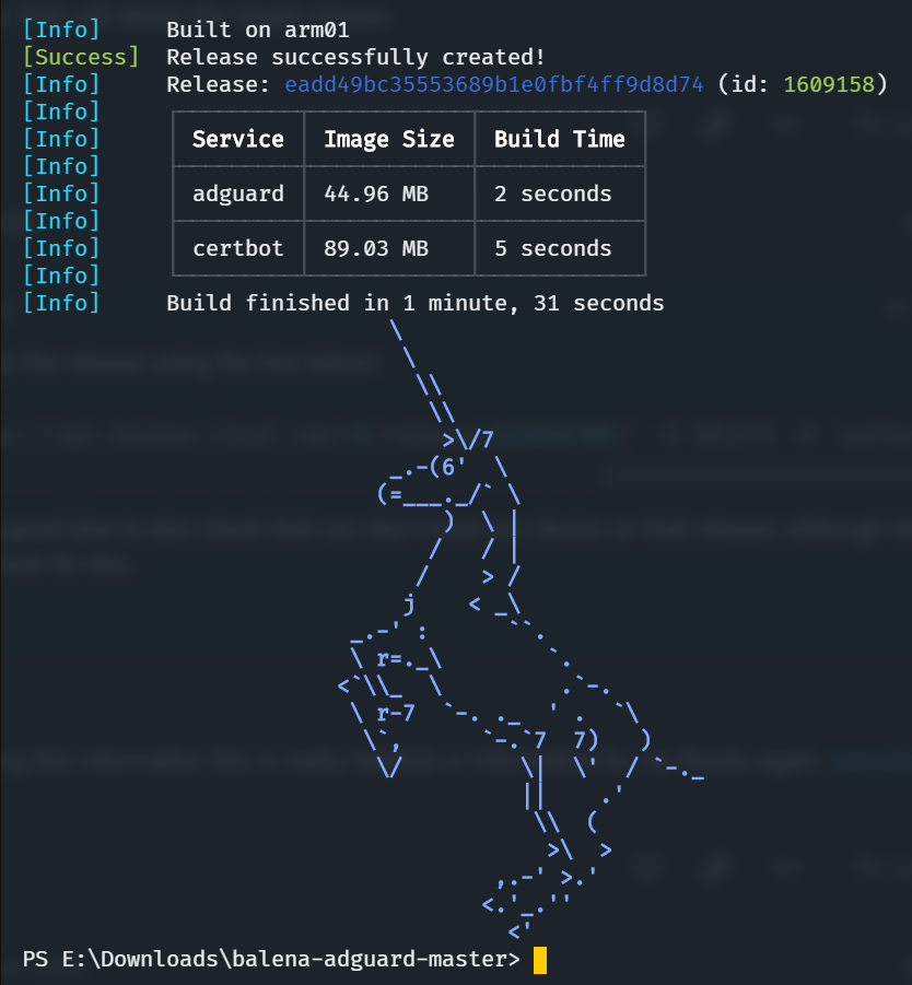

I’m having some problems as shown in the photo below.
Then I downloaded and push it to my device. Did I do something wrong, or do I have to download AdGuard Home’s image first?
Thank you for your help.
WOW, I got the unicorn!

I don’t know how I solved it. I just try something like that.
First, I used balena-engine pull adguard/adguardhome
And push your project to my device.
Then it works. There may have something wrong. I don’t know🤦‍♂️
