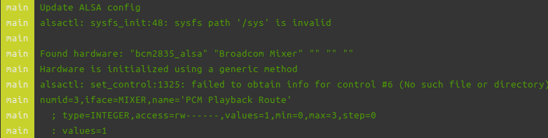

Hello @dedline
is that the output you get when following Odysseas’ suggestion?
