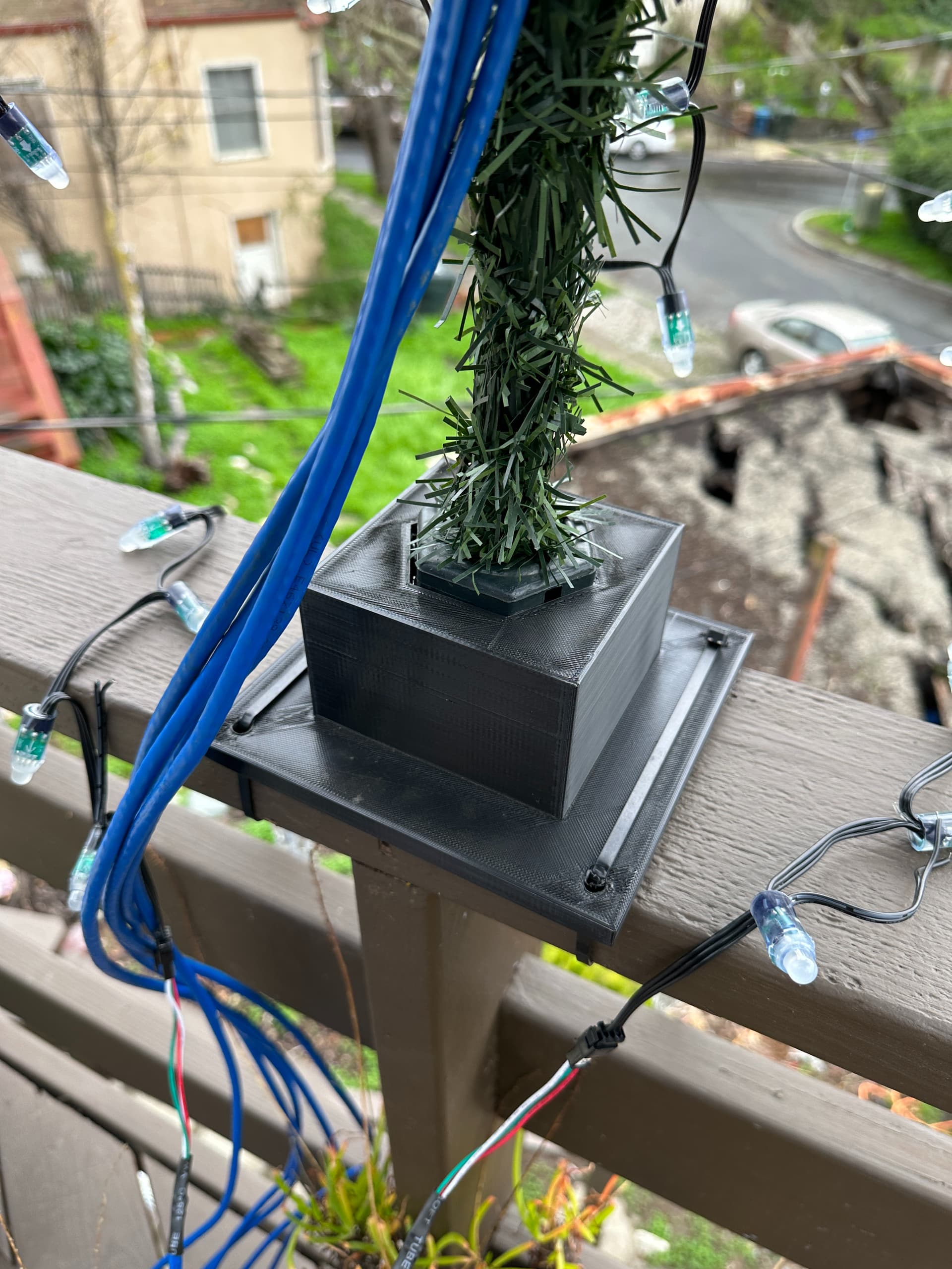

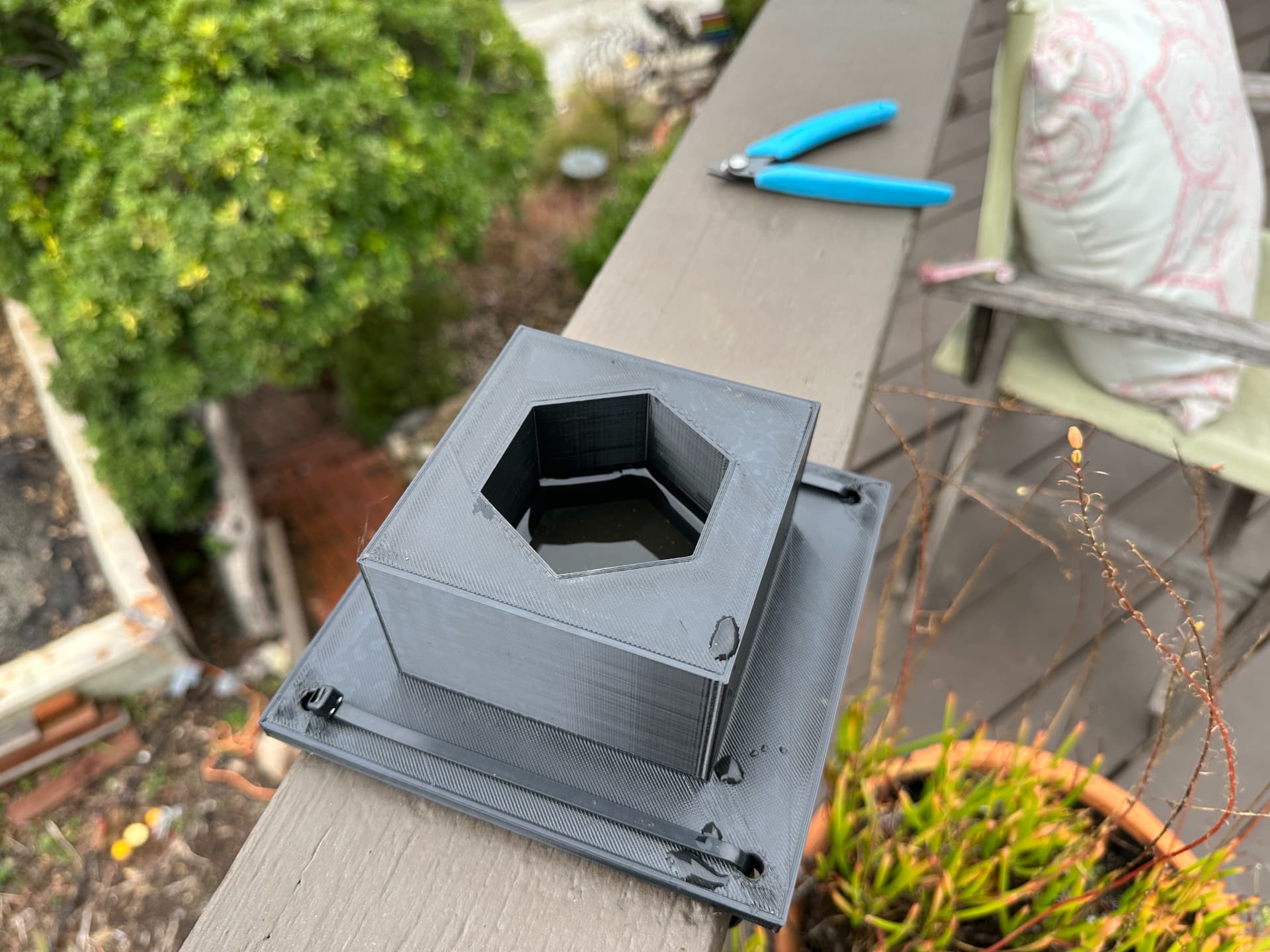

My panel-mount fuse holders have arrived, so - time for some Fusion 360 fun: I’ve been quite enjoying learning my way around that complicated tool. Case-in-point: I built and printed this custom ‘mount’ for the fake tree that serves as the ‘frame’ for my display. It replaces the three slide-in legs, which don’t work at all in my chosen (deck rail) mounting location.
